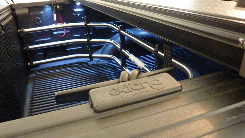

Security (Solid Fold Wins):
Yes, both units are secure but give me a hanger and I'll break in to any BakFlip by just lifting the corner near the bed and reaching for the release wire. Probably not practical but a thief could do it in seconds, see the location here:
Without pulling down the tailgate, nothing is opening the Solid Fold. The latches that hold it down are spring loaded which makes them way tougher than the release wire used by BakFlip.
This is a double-edged sword though. The quick action on the BakFlip makes it easier to open from either side of the bed vs visiting both sides of the bed to release the spring loaded mechanisms on the Solid Fold. I actually prefer the quick action of the BakFlip (which is why it won the first category above) but technically, the Solid Fold is more secure. But as with anything else, if someone really wants in, they'll figure a way to get in.
Day-to-Day Functionality (Solid Fold Wins):
The Solid Fold lets you close your tailgate while the cover is already in the down position (more below).
Plus, you can get the these add-on tie down cleats that allow you to put the tie down(s) almost anywhere along your bed rails. (You can see below that there is a pair of them towards the tailgate on my truck). You can even leave them put if you have no reason to move them because they fit under the cover.
Alternatively though ... if you have the bed cap with stake pockets, BakFlip retains access to those whereas the Solid Fold would cover them. Extang won this category because their cleats can move to where you need them and because they can be used under the cover. (If I had a picture of the BakFlip and pocket stakes together I would put it here). If you use those stake pockets more than cleats on the inside, you'll probably prefer the BakFlip in this category. Its noteworthy though that we had a few discussions that several models of the F150 removed access to the stake pockets with the new bad caps. You can see in my pics (see the security section) that I can't access mine either way.
