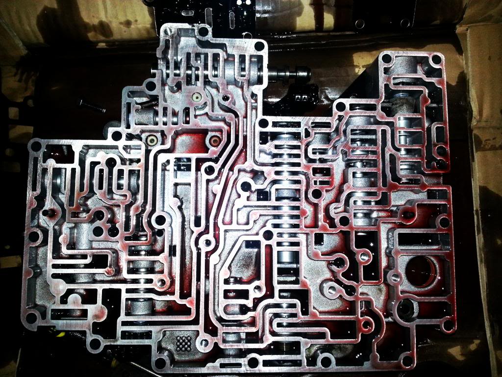

Got things apart.. found a broken piece on top of the retaining plate as in the 1st post...however, I cannot find the smaller piece, it's near the end and the ear, can't be but an inch or inch and half piece. I've looked in all the parts of the valve body and still can't find it. Looked on both sides of valve body.
I'm wondering if it too was sitting on the retaining plate and got drained with the fluid into my oil container?
Here's a pic, is there somewhere I should specifically look? Do I need to take out the OD valve?
The rest of the ring is wedged in the OD servo, intact. Gonna be a bear to get it out. So want to just leave it in as the servo def. is kept in place, but the rest of the ring will probably break at some point.
smaller piece probably got sucked up in the filter.

Follow up..... I found the smallest piece. It wrapped itself around one of the valve thingies (nice and technical term eh?) and only the ends were barely poking up. A small angled pick and a magnetic pickup tool and got it out.
Slapped it all back together and runs great. If I would of been able to find that piece quicker, the job would of only took about an 1-1/2hrs.
